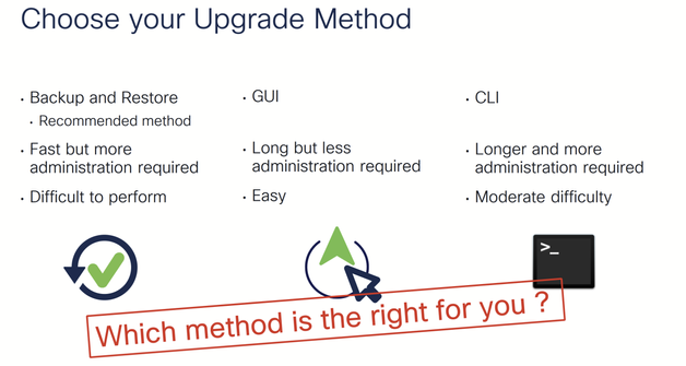

@benolyndav refer to the following Cisco guide - https://www.ciscolive.com/c/dam/r/ciscolive/emea/docs/2024/pdf/BRKSEC-2889.pdf which provides a break down of the upgrade methods. CLI still takes a long time compared to the GUI upgrade, but is considered more complex and more work.

@Rob Ingram
Yes I have watced these and had forgot about the cli method being long, I am thinking the upgrade hasnt got a chance of being succesful due to the 4 hour upgrade process time limit, any thoughts please, is the 480 just an approx figure or is it accurate ?
Thanks
@benolyndav the last upgrade I performed (3.1 > 3.2) was quicker than the URT stated. How big is your database? What hardware are you using (physical or VM)?
What about using the Backup and Restore method?
