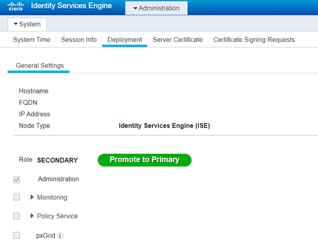

Hi @Bhardwajp ,
 are you able to log in to the Secondary PAN (GUI and CLI)?
 If the answer is yes, try to Promote the Secondary PAN to Primary, at: Administration > System > Deployment:
Hope this helps !!!

Hi @Bhardwajp ,
 sometimes promoting the Secondary PAN to Primary solves some database issues.
 In other words:
 1st promote Secondary PAN
 2nd test the GUI
 3rd if everything is OK, promote back the old Primary PAN
Hope this helps!!!
