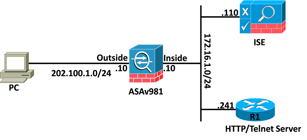

I want to test ISE Posture with AnyConnet on ASA, but the Client Provision cannot work correctly. However, when ISE Posture with BYOD is work corretly. Here some configuration on ASA and ISE captures.

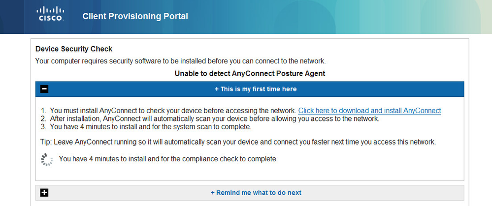

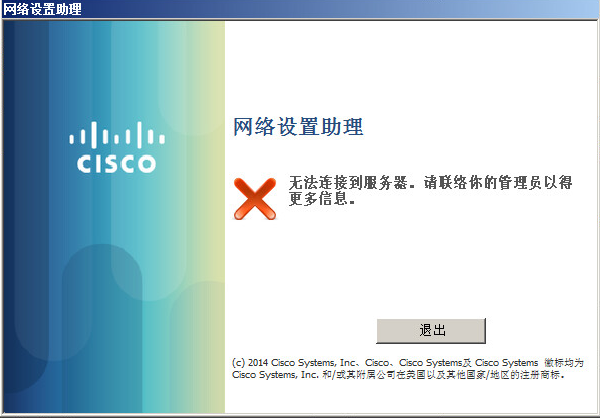

With Configure on ISE, the HTTP Redirect is working, and download anyconnect network assistant also as usual, but when run the assistant, it encouter error with "cannot connect to the server...". looks like the posture profile defined on ISE does not work properly. does anyone have same problems?

I don't see anything wrong in your second set of pictures. I assume that after you download the client you get the same error.
