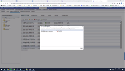

PSN node in Status updating whole time version 2.7 patch 6

I would try to dejoin it, remove its AD object, and then rejoin it to the AD.
Amen
the option De-join was not there so I rebooted the Server, and then did  ( join ) to the AD and it worked fine.
4 Replies 4
Hello, Thanks for your reply, but i tried that , credentials are correct , dns nslookup done , domain controller found
Still showing the same error
Do you have any firewall in between the node and the AD?
Amen
