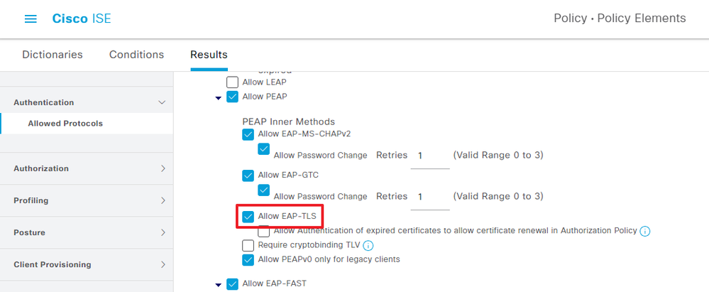

"PEAP Inner Methods" in ISE ???

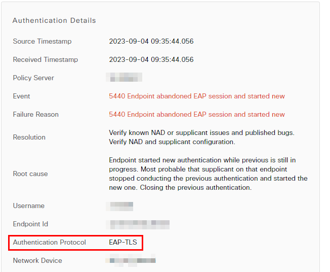

The PC attempts to connect wirelessly using PEAP-MSCHAPv2.
However, if you check the failure log in ISE, the authentication protocol is EAP-TLS.
Does it have something to do with EAP-TLS in PEAP Methods being allowed in ISE?
What are the risks of unchecking EAP-TLS?
Arne Bier
@JustTakeTheFirstStep - PEAP uses an outer TLS tunnel in which the "inner" methods are transported - e.g. MSChap-v2 and also, EAP-TLS. But I have not seen Windows supplicants using EAP-TLS as the inner method when EAP-PEAP is chosen during a connection to an SSID. But when you manually configure the WLAN, EAP-TLS is an option, as shown below from Windows 11.
