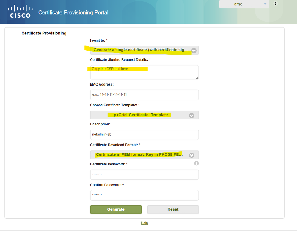

Paste your CSR from earlier into the portal. It requires all the password stuff etc. but since you already have the Private key on your ISE, you can just fill in a dummy password - you won't need the Private Key. The result will be a cert file that you can bind to your ISE.

I can't tell from your response whether you failed to generate the CSR, or whether you failed to generate the cert in the Cert Portal?
Here is what I did in ISE 3.2 patch 4 - for one of my lab nodes.
It generates the CSR as a text file.
Then hop over the Cert Portal - login.
I want to "Generate a single certificate (with certificate signing request)
Paste the CSR from the text file
And the rest goes like this
MAC Address - don't enter anything.
Certificate Download Format - Cert in PEM format (the second option in the drop-down)
Choose a password - you won't need it, but the portal forces you to enter one. It's pointless because the private key is on your ISE node, and the portal doesn't have it. This password is only required if the Portal had generated the CSR itself. That's when you have the private and public RSA key. The private key is the one that then gets password protected.
If all goes well, the portal spits out two files
You upload the file (shown at the bottom) back into the ISE CSR page (Bind Certificate)
