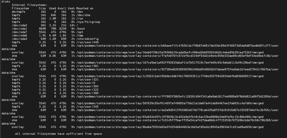

Thank you for the reply, @Mark Elsen. Below is the amount of free space that the 3.2 node has for each partition:ISE_Free_Space.png
Where would ISE attempt to copy the file to when the restore process is initiated? If it's the temp folder, then it has insufficient space available - 1.8GB free, and the backup file is approximately 5GBs. If that's the case, how do I get around this limitation? If that's not the issue, any idea what else I should look at? Unfortunately, our SolarWinds server did not have any useful logs for the SFTP server.
Thank you for all of your time and assistance.
        >.... If it's the temp folder, then it has insufficient space available - 1.8GB free,
  - That's probably a target problem which must be resolved. There is a simple trick to find out :
     Start a configuration restore again ; then use  your command to examine the filesystems let's say every
     second , or every 2 seconds : you will then be able  compare the previous output(s) and see which
     partition(s) are filling up.
     As far as expanding partitions on a linux-based VM on any hypervisor environment , you will find tons of info's
    by searching with relevant keywords as in :
                         https://www.nakivo.com/blog/increasing-the-size-of-a-disk-partition/
 M.
