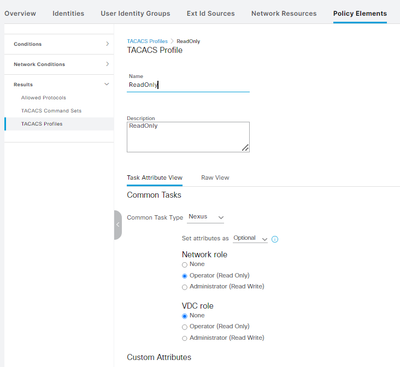

Hi Team,
Looking for Ansible API for the particular "Common Task type" to set as Nexus and by default it will choose Shell using API
cisco.ise.tacacs_profile, but couldn't able to find the API for the Nexus setup as per the below snip.
Please help me with the exact API or reference link

There is no such for those 'Common Task Types'. You would need to select the Raw View tab and build your API calls based on that data.
Example:
"TacacsProfile": {
"id": "e09c3a20-e250-11ee-a3a8-1296ee463e27",
"name": "Nexus_RO",
"description": "",
"sessionAttributes": {
"sessionAttributeList": [
"type": "OPTIONAL",
"name": "shell:roles",
"value": "\"network-operator\""
"link": {
"rel": "self",
"href": "https://ise32-3.ise.trappedunderise.com:9060/ers/config/tacacsprofile/e09c3a20-e250-11ee-a3a8-1296ee463e27",
"type": "application/json"

The easiest way to do this is to configure it in the GUI like you have done then perform a GET on the respective API object (tacacsprofile) to see what the REST object looks like:
curl  --include  --insecure  --location \
  --header 'Accept: application/json' \
  --header 'Content-Type: application/json' \
  --user $ISE_REST_USERNAME:$ISE_REST_PASSWORD \
  --request GET https://$ISE_HOSTNAME/ers/config/tacacsprofile/name/ReadOnly
  "TacacsProfile" : {
    "id" : "a8696100-e255-11ee-a872-5600453c2db2",
    "name" : "ReadOnly",
    "description" : "",
    "sessionAttributes" : {
      "sessionAttributeList" : [ {
        "type" : "OPTIONAL",
        "name" : "shell:roles",
        "value" : "\"network-operator\""
    "link" : {
      "rel" : "self",
      "href" : "https://198.18.133.27/ers/config/tacacsprofile/name/ReadOnly",
      "type" : "application/json"
You can then use that data to figure out what values to use in the respective cisco.ise.tacacs_profile module:
- name: Create TACACS Profile `ReadOnly`
  cisco.ise.tacacs_profile:
    ise_hostname: "{{ise_hostname}}"
    ise_username: "{{ise_username}}"
    ise_password: "{{ise_password}}"
    ise_verify: "{{ise_verify}}"
    state: present
    description: string
    sessionAttributes:
      sessionAttributeList:
      - name: "shell:roles"
        type: OPTIONAL
        value: "\"network-operator\""
