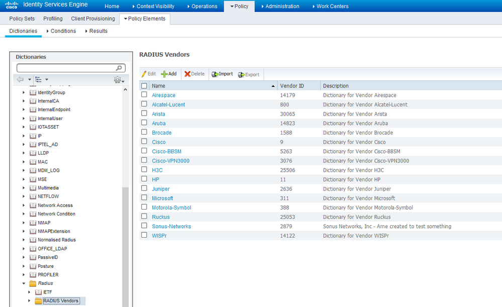

Does ISE support uploading dictionary files for radius configuration?
Arne Bier
Yes - but only if they are in the ISE format.  Go ahead and have a try.  I have done this for some obscure 3rd party vendor and it worked well.  You create the Dictionary in ISE via the GUI.  Then you have the option to export it.  And that means you can import that same Dictionary into another ISE platform.
