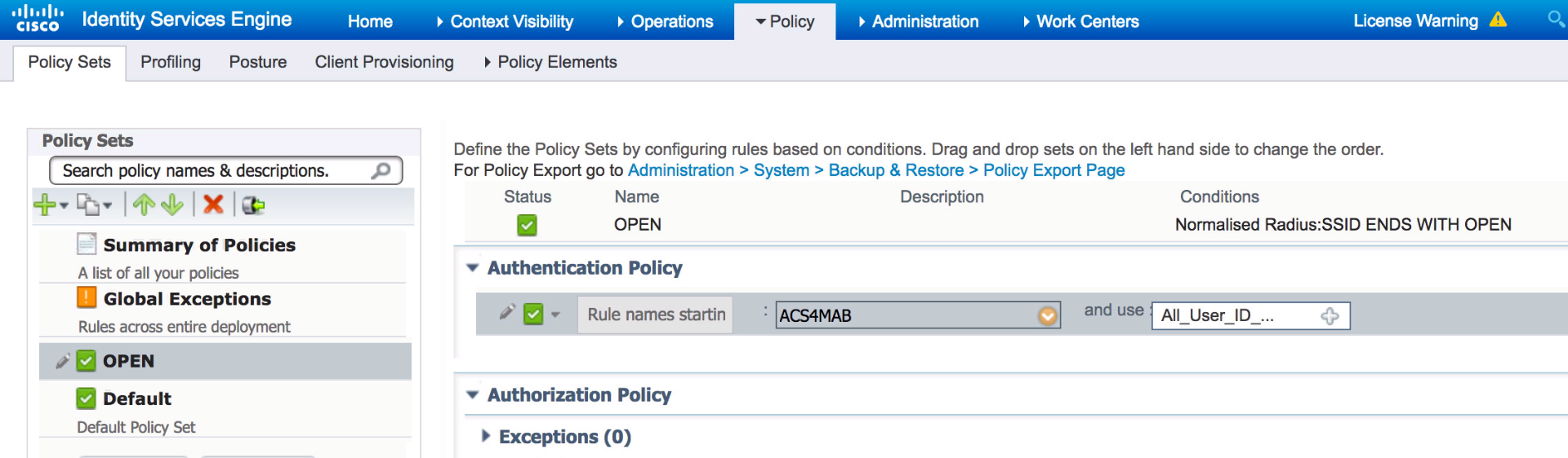

This essentially tells ISE to look for username & password from the MAB request without using the CID. Once custom allowed protocol has been created apply it to Authentication rule within the policy set.
