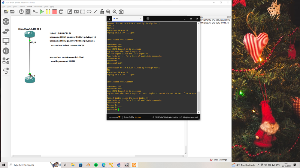

Case1
the config without enable password and aaa authen enable console LOCAL
you can see that both user even with different privilege can access ASA enable mode with any password, just press enter.
Case2
the config enable password and aaa authen enable console LOCAL
you can see that  user with Privilege 15 can access ASA enable mode with enter password we config before.Screenshot (175).png
you can see that user with privilege 1 can not access ASA enbale mode even if enter the enable password ~
