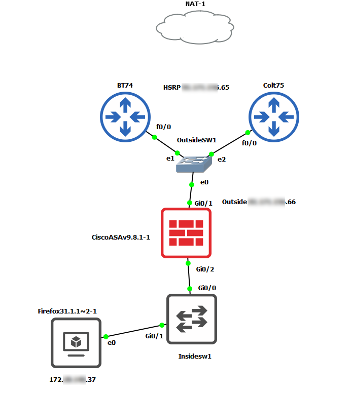

This is what I will do, however I'm not sure if I should add a NAT and connect to my real work subnet, or somehow put a simple device beyond the ISP routers to test the policy?
You could just place a router with loopback interface to simulate the Internet Address (E.g. 8.8.8.8). For example:

GNS3 is all running and the pings are hitting the remote device, but still taking the active HSRP path.
The route map is up too.
Had to reboot GNS3 and ping around to get things working.
If I ping from the PC on the inside I see it route via the active HSRP .74 IP and not .75.  What I do is run Wireshark on the link.
Because the remote device in GNS3 is a vPCS I have used this ACL, maybe it's not recognised?
access-list aw_interesting_traffic extended permit icmp host 172.x.x.37 any echo
access-list aw_interesting_traffic extended permit icmp host 172.x.x.37 any echo-reply
Do you see any hit count on your access list? Can you enable "debug policy-route" to have more detailed information?
I am curious why it would be forwarded via .74
What is the default gateway you have configured on inside PC?
If the route-map is hit, it would either via .65 (HSRP's MAC address) or .75 (Standby Router's MAC Address)..
