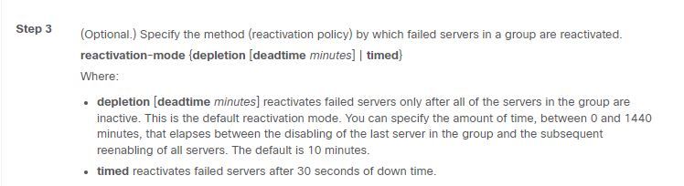

I see in document about command " reactivation-mode {depletion [deadtime minutes] | timed} " I'm not sure I will waiting 10 minutes or not for ASA go back to the first radius server . Please advise me.

I see in configuration guide  default configuration set 10 minutes . In this case I waiting 2nd server fail 1st server will coming or not
or necessary 2nd server fail . asa go to 1st server by automatic. because I try to test asa still go to 2nd not change.
When in depletion mode and as highlighted in the image, it will not go back or reactivate the 1st inactive server unless the 2nd server is also considered inactive.

By the way. I see in document. about mode is depletion . Will asa re-enable after 10minutes ?
The 10 mins dead interval is after the 2nd or the last server in the group fails and time it waits before activating all the servers again
