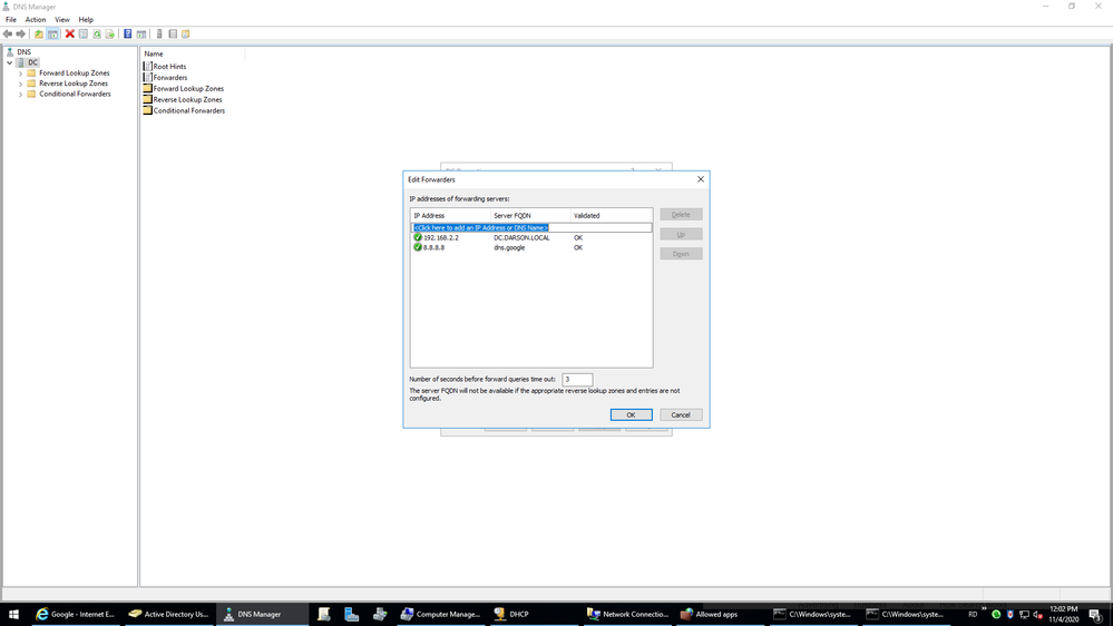

@Marius Gunnerudi have added a UDP port 523 rule in firewall in windows domain controller, and added dns 8.8.8.8 in ip settings, i can access the internet, but i am not able to lookup for google.com, hotmail.com anything, but internet is working on the client, i am trying to add dns forwarder in dns its resolving 8.8.8.8 to dns.google.com but when i am applying the settings its giving me error and after i click on OK button and then apply, after applying when i come to dns forwarder again the 8.8.8.8 entry doesnt show there, i am attaching screen shot please check and acknowledge please.dc.jpgDNS1.pngDNS2.png

@Marius Gunnerudi have done some steps, i have removed my domain contoller IP which is 192.168.2.2 from forwarder, and i have added only 8.8.8.8 in forwarder and also deleted all the root hints and applied and save the settings. now i am able to do nslookup on everything  (my internal clients, www.google.com, www.hotmail.com) a screen shot is attached for your kind consideration. please check and acknowledge and tell me what further i should do to give users internet access without mentioning the 8.8.8.8 in secondary dns ip. i want internet work on client with the primarry dns which is 192.168.2.2 and gateway which is 192.168.2.40 cisco asa. i appreciated your concern.123.jpg

@Marius Gunnerudreally appreciated your concern, the issue is resolved now, users are not able to use internet with the DNS 192.168.2.2
