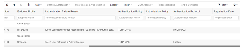

Hello
I have implemented some policies on Cisco ISE but it is using default policies instead of the ones i configured.
Can i please get help on it.
I have attached the the image below
22 Replies 22
The first PC i was troubleshooting is called Ian after enabling the disclosed invalid username it displayed the name Ian when connecting and the details as well as in the below screenshot.
But for the PC that's part of the domain, it is displaying as anonymous and when connected to the same port 10 on the switch it is bringing u the anyconnect pop-up

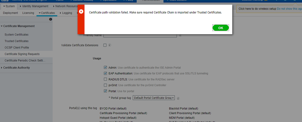

Ok i realized where the issue is. I havent done the certificate part yet and im facing issues binding the certificate signing requests.

Like I said before "Does the client computer trust the certificate presented by ISE?"
From your output:-
Failure Reason 12153 EAP-FAST failed SSL/TLS handshake because the client rejected the ISE local-certificate
Resolution Check whether the proper server certificate is installed and configured for EAP in the Local Certificates page ( Administration > System > Certificates > Local Certificates ).
I have not configured the certificates as it gives me this error. did not realize it would have this impact. And probably why the client computer does not receive the certificate to accept in the first place.

The username is hidden, select the disclose invalid username option as per screenshot below.
