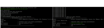

You do not have an SRU mismatch...if you did deploy would not be working at all even after reload. look at your LSP version and VDB version are the same so no issue here.

"I boiled this down to there not being allocated enough resources for the virtual machine.  The second time was because of a SRU mismatch between the SRU installed on the FTD and the one installed on FMC.  Had to manually update the SRU on the FTD to solve this issue."
--- i have checked everything and seems resources are memory @30%, disk @10%
For SRU i think it has a mismatch but i am wondering why it has a mismatch, i even downloaded the latest SRU from the support site and deploy it to the FTD but the version in FTD is still outdated. do you have a tutorial or notes on how to manually update the SRU in FTD side?
So far  the deployment error has gone and did not show up again after the FMC reboot. but i need to fix this SRU mismatch between FTD and FMC. do you have a notes for this sir? Thank you in advance.

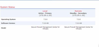

Are you sure that you are running 7.3?  It should be present. If you are running 7.3 then this might be a bug.  Have you tried reloading the FMC?

Hi Sir, my FMC is 7.3.0 but my FTD is still 7.0.4. Would that be safe to downgrade my FMC to 7.2.1?
Regarding PBR maybe the PBR in devices-> routing is missing because i am running 7.0.4 FTD and 7.3.0 FMC?
PBR is supported from 7.1 so it could be that your FTD is on 7.0 that is the problem why you are not seeing it in the GUI
