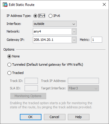

I was replicating what I have live on the 5550.  The static for my gateway on the 5550 is
The other static IPs are 208.104.20.145 and 208.104.20.198 which I use NAT rules to handle to other inside IPs.  For now I am just trying to get the 1120 able to connect outside and register it and of course make use of it in place of the 5550.  When I look at the ARP table on the 5550 it shows 208.104.20.1 on the "outside" interface which is the gateway from the ISP.
OK, you should be able to get things going then if you put that gateway address in as the static default route for your system's dataplane. Your FDM GUI screenshot indicates you haven't configured any routes yet. (The default setup uses DHCP with setroute option.)
Is that not what this is?
Oh OK - I was going by the first screenshot which said no routes.
What's causing the Eth 1/1 interface status to be orange? Hovering over it should bring up a status tooltip.
Sorry about that, the screen shot was before I added the static.  I was following the documentation and thought what I had should work.  Right now the 1120 is not connected to the cable modem.  When attached to the cable modem it will go green.  I did power down the cable modem and the 1120 before moving from 5550 to the 1120.  Even though it was green I got the same message about the gateway and ISP/WAN/Gateway box never changes colors (assuming it would).  1/9 which is my internal network goes green and all of the devices inside on the switch see each other but of course none can get outside.  I get the message about the gateway even when attached to the cable modem.  My daughter and I both work remote from home so need network up during business hours.  Let me know what else you need to review and I can send a word doc with current screen shots.  Thx
Attached is screen shots of everything (I think).
Like @johnlloyd_13 said - correct the NAT configuration and deploy.
