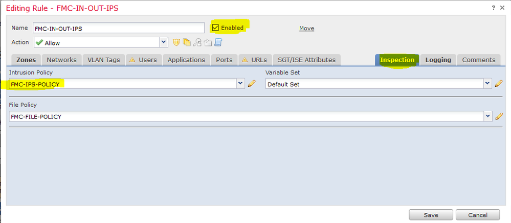

did you create Access Policy and selected the inspection using the policy you created? like the access policy below?

You can add new policy in access rules
source inside destination outside
then enable the inspection as in the image and select your ips policy
that should be it
