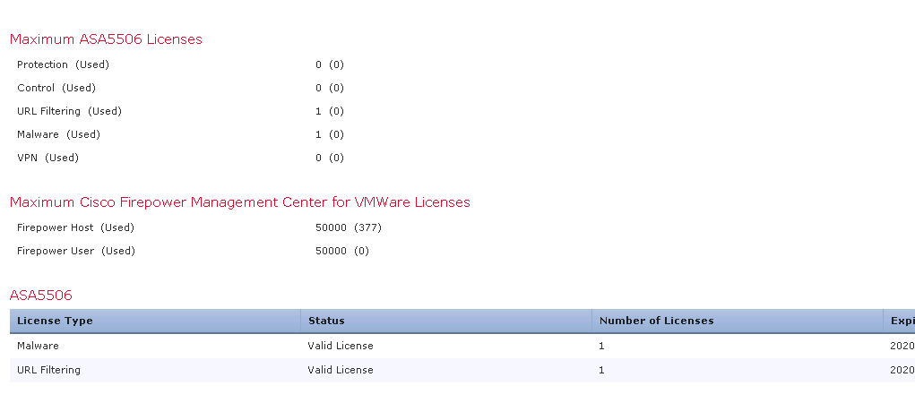

I suspect i might be doing something wrong, but i have hosted the license on FMC version 6.2.1 is what i am using. However, i still cannot enable the license on the device tab.
[@david.funmi@eu.didata.com]  ,
Are you using classic licenses (i.e. anything other than FTD)? What sensor type? If it's an ASA FirePOWER service module you need the free Control license first before you can apply IPS, URL or Malware licenses.
hi Marvin,
Yes, classic licenses and;
Yes ASA firePOWER module on 5506x ASA
I have uploaded a screen shot of my FMC license page.
How can i obtain the free control license?
Regards
The Control license is provided in the box with the ASA as a printed form with the PAK on it.
If you don't have it anymore, there are a couple of routes you can take:
1. If you purchased through a Tier 1 reseller or partner they can call it up in the Cisco order fulfillment system (the PAK shows up as part of the delivered hardware).
2. You can open a case with TAC (ask for Global Licensing Operations or GLO team) and provide the serial number and they can do the same.
3. You can email licensing@cisco.com for it.
In any case it is definitely required. You cannot apply any other licenses or deploy access control policies without it.
