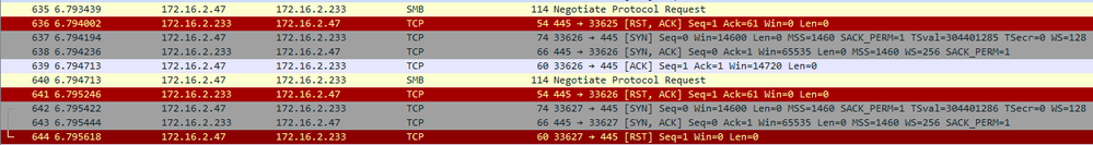

Wireshark shows the SMB Negotiate Protocol Request being sent from the FMC but the destination host sends a RST flag resetting the connection.
I have no clue what could be causing this.
A TCP reset from the target host generally means it's not accepting connections on that port or protocol or else it restricts them to certain addresses (e.g. in Windows firewall).
