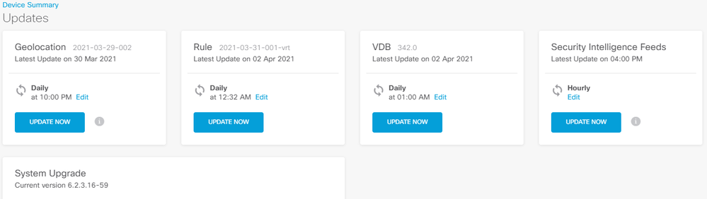

I'm using FTD on ASA 5506x v6.2.3.16-59 (managed by Firepower Device Management) with updates:

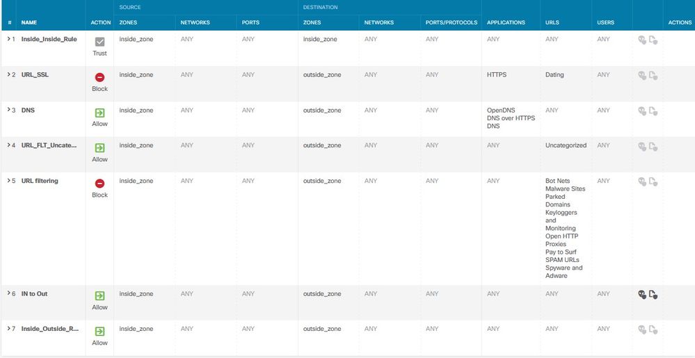

My rule set looks like:
Please let me know if I should modify my rule set.

I've decided to create dedicated rule for Uncategorised URL's (rule number 4)
and now in logs, traffic to https://speed.cloudflare.com/  hit rule "IN to OUT" (rule number 6)
Thats good for me, but I'm still looking  for explanation why it was blocked previously.
