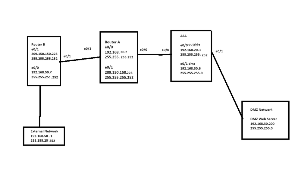

How can we allow External Network to access DMZ network?
Beginnerrr
I am trying to configure the ASA to allow the External Network to access web service provided by DMZ web server which is on the DMZ network. Above is my network diagram.
In My ASA configuration.
route 0.0.0.0 0.0.0.0 next hop router
interface e0/0
nameif outside
security-level 0
192.168.20.1 255.255.255.252
interface e0/1
nameif dmz
security-level 70
192.168.30.6 255.255.255.0
object network external-network
subnet 192.168.50.0 255.255.255.252
object network dmz-server
host 192.168.30.200
nat (dmz,outside) static interface
WARNING: All traffic destined to the IP address of the outside interface is being redirected.
WARNING: Users may not be able to access any service enabled on the outside interface.
access-list external_web_in extended permit tcp object external-network object dmz-server eq www
access-group external_web_in in interface outside
I am unable to access web service on the DMZ server from the External network.
I performed packet tracer and do not see any errors and failures.
The command is packet-tracer input outside tcp 192.168.50.5 1025 192.168.30.200 80 and the output is shown below

Please kindly assist.
Thank you
@Beginnerrr you can use static NAT or PAT, either NAT behind the outside interface IP or specify another "public" IP address local to your ASA outside interface network. Example:
Static PAT:
object nat dmz-server-tcp80
 host 192.168.30.200
 nat (dmz,outside) static interface service tcp 80 80
Static NAT:
 host 192.168.30.200
** or replace "interface" with an IP address routed to the outside interface of the ASA.

Router know the subnet of dmz?
You need static route in router toward ASA for dmz server.
@MHM Cisco World , External Router cant know the subnet and the route of DMZ as DMZ is supposed to be hidden..
Yes if you use NAT
Your config without NAT so router need to know subnet of server.
https://www.cisco.com/c/en/us/support/docs/security/asa-5500-x-series-next-generation-firewalls/115904-asa-config-dmz-00.html
Check this.
@MHM Cisco World ,so if I want to use NAT, how do I configure for this situation? Can I use dynamic NAT or static NAT?
Static not dynamic NAT what you need.
Static is bidirectional NAT'
We config as
Nat(dmz'out)
And the external can access server in dmz using outside IP (mapped) not real IP' this way we hide server IP from external.
Static PAT:
 host 192.168.30.200
Static NAT:
 host 192.168.30.200
@Rob Ingram , I configure the NAT under the dmz-server. I configure the interface to be the same as the External device IP.
It did not work.
interface e0/0
nameif outside
security-level 0
192.168.20.5 255.255.255.0
interface e0/1
nameif dmz
security-level 70
subnet 192.168.50.0 255.255.255.0
host 192.168.30.200
nat (dmz,outside) static 192.168.50.5
@Beginnerrr  the NAT IP address is either "interface" which uses the IP address of your outside interface (192.168.20.5) or you specify another IP address within that 192.168.20.0/24 range - you don't specify a network that is not routable to your ASA's outside interface.
 host 192.168.30.200
Change the NAT above and then connect to 192.168.20.5 from the outside network. Obviously 192.168.20.0/24 needs to be routable from the outside network (I assume this is a lab or private WAN environment).
@Rob Ingram , yes this is my lab and I have updated the diagram for a more clearer explanation. Assuming if you mention that the IP need to be a public ip in order to be routable from the outside network. Then the interface should be 209.150.150.225.
Is that correct?
@Beginnerrr you just need to define the NAT rule as per the example provided above and traffic to your outside interface IP address will be translated to 192.168.30.200. As it's a lab try the commands for yourself to understand how it works.
