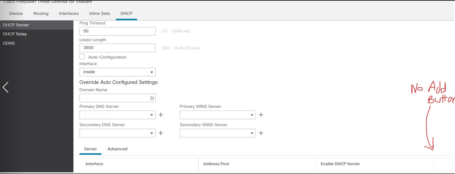

Hi All,
I'm unable to add a DHCP server on my FTDs using FMC version 7.0.1.1
There is no add button to add the DHCP server. I have attached a screenshot.
Has anyone encountered this issue?
Thanks,
Rod
This could be due to a Browser issue, ( i am guessing maybe new chrome browsers having some issue)
I always use firefox if we see this kind of issue, glad you figure out the issue.
BB

I asume you already have IP interfaces configured? Do you have DHCP Relay enabled on another interface? Then you can’t enable DHCP server.
Hi Karsten,
I do have IP interfaces configured.
I don't have DHCP relay configured, but I do have the option to add a DHCP relay. Unfortunately, no option to add DHCP server.

i would verify the configuration again as mentioned steps :
https://www.cisco.com/c/en/us/support/docs/security/firepower-ngfw/200475-Configure-DHCP-Server-Relay-on-FTD-Using.html

Hi All,
I tried configuring the FMC with a Ubuntu PC and I can see the Add button and can add a DHCP server.
I'm not sure why the Add button was missing when using my Windows PC?
I'll investigate this later.
Thanks,
Rod
BB
Thanks BB,
I tried Chrome and Edge on my Windows 11 PC but no Add Button.
I downloaded Firefox on Windows 11 (it worked on Ubuntu) and the button was there.
Thanks,
Rod
Not sure what is the relation here cisco and Chrome, even i see some WLC / WSA admin GUI has some issues.
firefox and old IE work as expected.
Thank you for the feedback, it will help other community members your feedback resolve if they have the same issue.
BB
