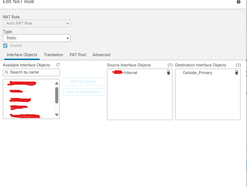

I am traying to reach a website that is on an inside webserver, but I am failing to configure the NAT properly to allow the traffic. In the original source I have the private IP of the server, in the translated source I have the Public IP address which will be used to access the website. I hope anyone can help

I finally opened a Ticket with TAC. I had a mistake on the ports and on the Zone. Below are pictures of how the policy was done and an explanation of my understanding of how it works. Feel free to correct me if I got something wrong
The original destination is the public IP on which the website will be published to the internet. This will be done thru the outside or internet interface, even if you have a subnet of public IP's and are using one IP from the range to publish the page that is different from you WAN interface public IP. This is very important.
The translated destination is the actual private IP of the webserver on your internal network.
I had all that correct but I had a mistake on the ports, I had the ports specified on the original and source port but that is used in the other NAT rule where you publish the page. In this wan you are intercepting traffic that is already been thru NAT so it is going to a destination port and that's where you put the information. Original destination and translated destination.
I hope this can help anyone.
