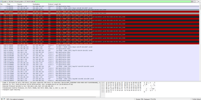

I have had a failed migration attempt due to VDI access not working after the migration and have had to roll back. I took a wireshark from the client at the time.
After the roll back I have ran some packet captures on the live ASA and the non live FTD.
Just running a capture from the FTD and ASDM.
I can see the when testing from an dummy address of 1.1.1.1 to 217.146.101.212 port 8443 traffic is allowed and natted to 172.16.230.19 as expected.
When running the same test from FTD it is failing at the SNORT inspection, something that isn’t present on the ASA. I will investigate this further as unsure if this is a cause or red herring atm.
On the FTD it would appear the correct ACLs and NAT statements are being hit. But denied by SNORT.... Should I allow a process through SNORT?
Searching for the SNORT 3 rule ID but nothing is showing..

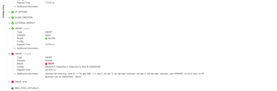

Output no prefilter
Packet Details:
09:22:08.305 - 1.1.1.1:1 > 217.146.101.212:8443 TCP
GC2_Outside(vrfid:2)
CAPTURE
Type:
CAPTURE
Result:
ALLOW
Config:
Elapsed Time:
25889 ns
Additional Information
Forward Flow based lookup yields rule:
in id=0xffb801f4b0, priority=13, domain=capture, deny=false
hits=140103, user_data=0xffd9c900e0, cs_id=0x0, l3_type=0x0
src mac=0000.0000.0000, mask=0000.0000.0000
dst mac=0000.0000.0000, mask=0000.0000.0000
input_ifc=GC2_Outside, output_ifc=any
ACCESS-LIST
Type:
ACCESS-LIST
Result:
ALLOW
Config:
Implicit Rule
Elapsed Time:
25889 ns
in id=0xffb452d080, priority=1, domain=permit, deny=false
hits=5797287, user_data=0x0, cs_id=0x0, l3_type=0x8
dst mac=0000.0000.0000, mask=0100.0000.0000
UN-NAT
| static
Type:
UN-NAT
Subtype:
static
Result:
ALLOW
Config:
nat (DMZ_POD2_EXT,GC2_Outside) source static DMZUAG_VIP4 obj_217.146.101.212
Elapsed Time:
19915 ns
NAT divert to egress interface DMZ_POD2_EXT(vrfid:2)
Untranslate 217.146.101.212/8443 to 172.16.230.19/8443
OBJECT_GROUP_SEARCH
Type:
OBJECT_GROUP_SEARCH
Result:
ALLOW
Config:
Elapsed Time:
0 ns
Source Object Group Match Count: 1
Destination Object Group Match Count: 2
Object Group Search: 2
ACCESS-LIST
| log
Type:
ACCESS-LIST
Subtype:
log
Result:
ALLOW
Config:
access-group CSM_FW_ACL_ global access-list CSM_FW_ACL_ advanced permit ip ifc GC2_Outside any ifc DMZ_POD2_EXT any rule-id 268443040 access-list CSM_FW_ACL_ remark rule-id 268443040: ACCESS POLICY:ACP_PCH_INTERNET Default access-list CSM_FW_ACL_ remark rule-id 268443040: L7 RULE:outside_access_horizion_block
Elapsed Time:
796 ns
This packet will be sent to snort for additional processing where a verdict will be reached
in id=0xffb40ab910, priority=12, domain=permit, deny=false
hits=2, user_data=0x5586a1da00, cs_id=0x0, use_real_addr, flags=0x0, protocol=0
src ip/id=0.0.0.0, mask=0.0.0.0, port=0, tag=any, ifc=GC2_Outside(vrfid:2)
dst ip/id=0.0.0.0, mask=0.0.0.0, port=0, tag=any, ifc=DMZ_POD2_EXT(vrfid:2),, dscp=0x0, nsg_id=none
input_ifc=any, output_ifc=any
CONN-SETTINGS
Type:
CONN-SETTINGS
Result:
ALLOW
Config:
class-map class-default match any policy-map global_policy class class-default set connection advanced-options UM_STATIC_TCP_MAP service-policy global_policy global
Elapsed Time:
796 ns
in id=0xffe29e22d0, priority=7, domain=conn-set, deny=false
hits=17335, user_data=0xffe29dec20, cs_id=0x0, use_real_addr, flags=0x0, protocol=0
dst ip/id=0.0.0.0, mask=0.0.0.0, port=0, tag=any, dscp=0x0, nsg_id=none
input_ifc=GC2_Outside(vrfid:2), output_ifc=any
NAT
Type:
NAT
Result:
ALLOW
Config:
Elapsed Time:
796 ns
Static translate 1.1.1.1/1 to 1.1.1.1/1
in id=0xffb9add2f0, priority=6, domain=nat, deny=false
hits=1368, user_data=0xffb93fe170, cs_id=0x0, flags=0x0, protocol=0
dst ip/id=217.146.101.212, mask=255.255.255.255, port=0, tag=any, dscp=0x0, nsg_id=none
input_ifc=GC2_Outside(vrfid:2), output_ifc=DMZ_POD2_EXT(vrfid:2)
NAT
| per-session
Type:
NAT
Subtype:
per-session
Result:
ALLOW
Config:
Elapsed Time:
796 ns
in id=0x55a461b2d0, priority=0, domain=nat-per-session, deny=false
hits=93756, user_data=0x0, cs_id=0x0, reverse, use_real_addr, flags=0x0, protocol=6
IP-OPTIONS
Type:
IP-OPTIONS
Result:
ALLOW
Config:
Elapsed Time:
796 ns
in id=0xffb4532010, priority=0, domain=inspect-ip-options, deny=true
hits=58065, user_data=0x0, cs_id=0x0, reverse, flags=0x0, protocol=0
FOVER
| standby-update
Type:
FOVER
Subtype:
standby-update
Result:
ALLOW
Config:
Elapsed Time:
34709 ns
in id=0xffdc592590, priority=20, domain=lu, deny=false
hits=14309, user_data=0x0, cs_id=0x0, flags=0x0, protocol=6
NAT
| rpf-check
Type:
NAT
Subtype:
rpf-check
Result:
ALLOW
Config:
Elapsed Time:
10242 ns
out id=0xffb9add720, priority=6, domain=nat-reverse, deny=false
hits=1278, user_data=0xffb8277c50, cs_id=0x0, use_real_addr, flags=0x0, protocol=0
dst ip/id=172.16.230.19, mask=255.255.255.255, port=0, tag=any, dscp=0x0, nsg_id=none
NAT
| per-session
Type:
NAT
Subtype:
per-session
Result:
ALLOW
Config:
Elapsed Time:
71125 ns
Reverse Flow based lookup yields rule:
hits=93758, user_data=0x0, cs_id=0x0, reverse, use_real_addr, flags=0x0, protocol=6
IP-OPTIONS
Type:
IP-OPTIONS
Result:
ALLOW
Config:
Elapsed Time:
1707 ns
in id=0xffd84dcdf0, priority=0, domain=inspect-ip-options, deny=true
hits=14497, user_data=0x0, cs_id=0x0, reverse, flags=0x0, protocol=0
input_ifc=DMZ_POD2_EXT(vrfid:2), output_ifc=any
FLOW-CREATION
Type:
FLOW-CREATION
Result:
ALLOW
Config:
Elapsed Time:
63159 ns
New flow created with id 68454, packet dispatched to next module
Module information for forward flow ...
snp_fp_inspect_ip_options
snp_fp_tcp_normalizer
snp_fp_snort
snp_fp_translate
snp_fp_adjacency
snp_fp_fragment
snp_fp_tracer_drop
snp_ifc_stat
Module information for reverse flow ...
snp_fp_translate
snp_fp_snort
snp_fp_adjacency
snp_fp_fragment
snp_fp_tracer_drop
snp_ifc_stat
EXTERNAL-INSPECT
Type:
EXTERNAL-INSPECT
Result:
ALLOW
Config:
Elapsed Time:
23329 ns
Application: 'SNORT Inspect'
SNORT
| appid
Type:
SNORT
Subtype:
appid
Result:
ALLOW
Config:
Elapsed Time:
15760 ns
service: (0), client: (0), payload: (0), misc: (0)
SNORT
| firewall
Type:
SNORT
Subtype:
firewall
Result:
DROP
Config:
Network 0, Inspection 0, Detection 4, Rule ID 268443040
Elapsed Time:
291876 ns
Starting rule matching, zone 41 -> 14, geo 840 -> 0, vlan 0, src sgt: 0, src sgt type: unknown, dst sgt: 0, dst sgt type: unknown, user 9999997, no url or host, no xff
Matched rule ids 268443040 - Block
Result: drop
Input Interface:
Input Status:
up
Input Line Status:
up
Output Interface:
Output Status:
up
Output Line Status:
up
Action:
drop
Time Taken:
587580 ns
Drop Reason:

Result: drop
Input Interface:
Input Status:
up
Input Line Status:
up
Output Interface:
Output Status:
up
Output Line Status:
up
Action:
drop
Time Taken:
273685 ns
Drop Reason:
(no-v4-adjacency) No valid V4 adjacency. Check ARP table (show arp) has entry for nexthop.
Drop Detail:
Drop-location: frame 0x000000aaad9e1cac flow (NA)/NA
The FTD has not been migrated yet and interfaces are not up. Is this the reason why the error - (no-v4-adjacency) No valid V4 adjacency. Check ARP table (show arp) has entry for nexthop is showing in the packet capture
So based on the packet capture, there are two scenarios one without a prefilter and one with a prefilter.
The packet is dropped by SNORT inspection due to Rule ID 268443040. The result shows:
SNORT
| firewall
Type: SNORT
Subtype: firewall
Result: DROP
Config: Network 0, Inspection 0, Detection 4, Rule ID 268443040
The drop reason is given as "(firewall) Blocked or blacklisted by the firewall preprocessor". With Prefilter: The packet is allowed to pass through without being dropped by SNORT. The key difference is in the ACCESS-LIST section
ACCESS-LIST
| log
Type: ACCESS-LIST
Subtype: log
Result: ALLOW
Config: access-group CSM_FW_ACL_ global access-list CSM_FW_ACL_ advanced trust ip ifc GC2_Outside any ifc DMZ_POD2_EXT object DMZUAG_VIP4 rule-id 268443041 event-log flow-end access-list CSM_FW_ACL_ remark rule-id 268443041: PREFILTER POLICY: PF_PCH_INTERNET access-list CSM_FW_ACL_ remark rule-id 268443041: RULE: VDI-ALLOW
This prefilter rule (268443041) allows the traffic to bypass SNORT inspection, effectively resolving the issue of the packet being dropped.
"The FTD has not been migrated yet and interfaces are not up. Is this the reason why the error - (no-v4-adjacency) No valid V4 adjacency. Check ARP table (show arp) has entry for nexthop is showing in the packet capture"
The FTD's interfaces are currently down due to a pending migration. This explains the "no-v4-adjacency" error and the lack of a valid ARP entry for the nexthop in the packet capture. Once the migration is complete and the interfaces are up, the ARP table should populate, and the packet trace should succeed.
Hope this help
