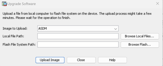

You can upload the ASDM software via ASDM, go to tools > Upgrade software from local computer

Well, I was trying to upgrade the ASDM again but to a later version. So I mistakenly, removed the older version via CLI, then tried to TFTP over the newer version but couldn't so trying to figure out how to do via CLI. And because the ASDM module is no longer on the appliance, I cannot download via web browser(https://x.x.x.x:xxxx).
