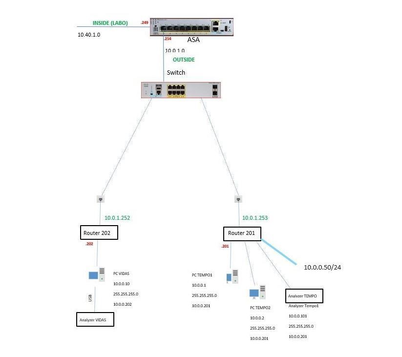

My question is that there are 2 networks directly connected to the ASA and a third which is not.
10.40.1.0 ( INSIDE) ==>ASA==>10.0.1.0 (OUTSIDE)==>Router / firewall (not managed by me) with INSIDe interface 10.0.1.253, outside interface 10.0.0.201==>PC2 (10.0.0.50/24 GW:10.0.0.201).

ANd yes from a PC in inside network (10.40.1.4), I can PINg 10.0.0.50 and i can acess to his FTP, but not in https
From a pc from the same network (PC TEMPO1 for exemple in my diagram), i can access web server to 10.0.0.50
Again this not work since the same subnet connect to multi L3 devices
MHM
Why? i have static route for each PC of the outside interface
