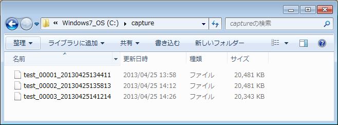

Configure the setting to write the data directly on the disk to obtain capture over a long period of time with Wireshark.
In consideration of the performance of the PC that performs analytical processing, the file to be written will be divided into multiple files (Use multiple files).
The following setting is an example for dividing the captured file by 20 megabytes (Next file every).
The ring buffer setting (Ring Buffer with) is set to 50 files as the capacity of the hard disk of the PC that implements capturing is limited.
In this case, files are saved from file 1, file 2 ... to file 50, at which point it goes back to file 1 to save.

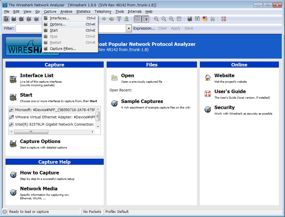

Select "Capture > Options" from the menu bar.

Packet capturing is initiated using the above settings. Multiple capture files are generated in the designated directory.

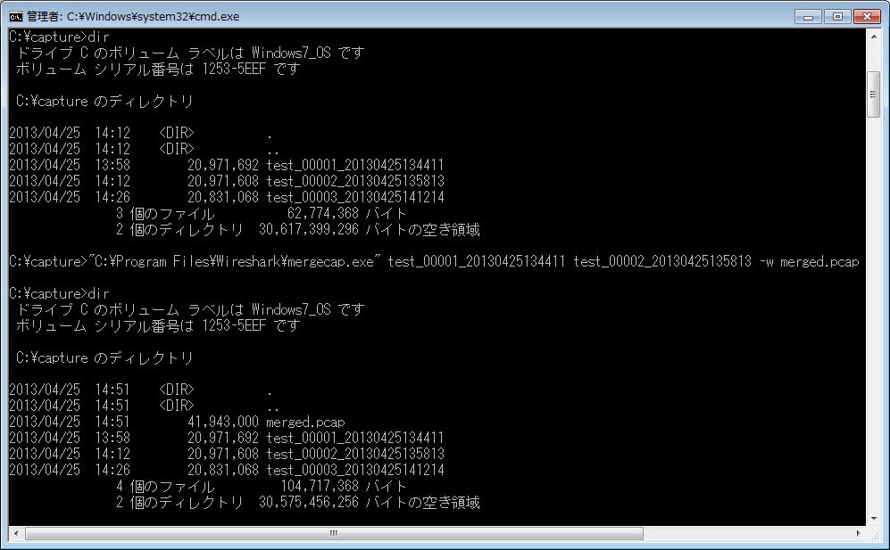

If you want to perform analytical processing as one file, files need to be merged.
In the following example, divided capture files are merged into one file by the command (mergecap.exe) attached to Wireshark.
(Format of the mergecap command: mergecap.exe Ingress file name 1 Ingress file name 2 -w Egress (merge) file name)
The merged file is read into Wireshark again to perform analytical processing, such as signaling and RTP.
