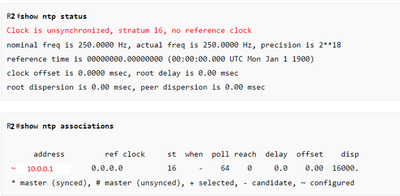

These tell us that R2 has 10.0.0.1 configured as the NTP server and it’s currently not synchronized.
This debug tells us that R1 is sending NTP packets, and R2 is receiving anything.
Troubleshooting NTP
There are a couple of things that could go wrong with NTP:
  • NTP traffic filtered: access-lists could block NTP traffic.
  • NTP Authentication issues: NTP supports authentication, client and server need to use the same settings.
  • Time offset too high: When the time offset between client/server is too large it will take a very long time to synchronize.
  • Stratum level too high: The stratum level is between 1 (best) and 15 (worst). A stratum level of 16 is considered unusable.
  • NTP server source filter: NTP servers can be configured to allow only clients from certain IP addresses.
Once you confirm that NTP packets are not received, you must:
  • Check if NTP is configured correctly.
  • Check if an ACL blocks NTP packets.
  • Check for routing issues to the source or destination IP.
