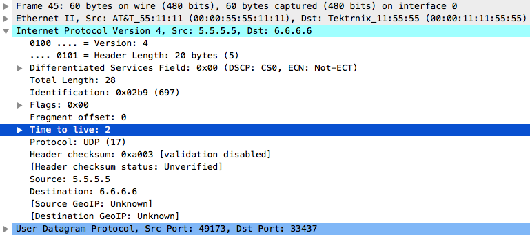

At the first step, PE-1 performs the normal IP routing housekeeping. It receives a second probe from the originator of the trace with a TTL value of 2 as seen below.

In an MPLS core, when an LSR receives an IP packet, it decrements the TTL value from the IP header by one (2-1) and copies the new value to all the labels that need to be imposed onto the label stack.
The capture above shows that PE-1 has imposed a VPN label (Label: 403) on top of the original IP packet followed by a Transport Label (Label: 201). In the MPLS Core, the packet will be switched based on the Transport Label.  As per the LFIB on PE-1, IP packets that use 4.4.4.4 as next hop should have the outgoing label 201 and exit interface Fa2/0.

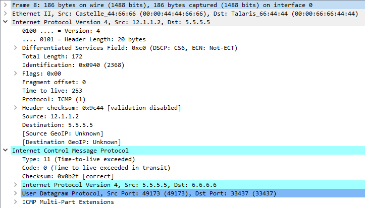

P1 adds label 300  in front of the IP header which has the ICMP “TTL Exceeded” messages as the payload. Since this is a new packet, the TTL value 255 is copied from the new IP header to the newly imposed labels. The packet is now forwarded as per the LFIB above, out F3/0 interface, towards the next intermediate LSR, P2.

The LFIB on P2 indicates “pop label” for the packets with the incoming label of 300. This means P2 performs PHP by removing the transport label, leaving the VPN label intact. P2 decrements the TTL of the VPN label to 254.
