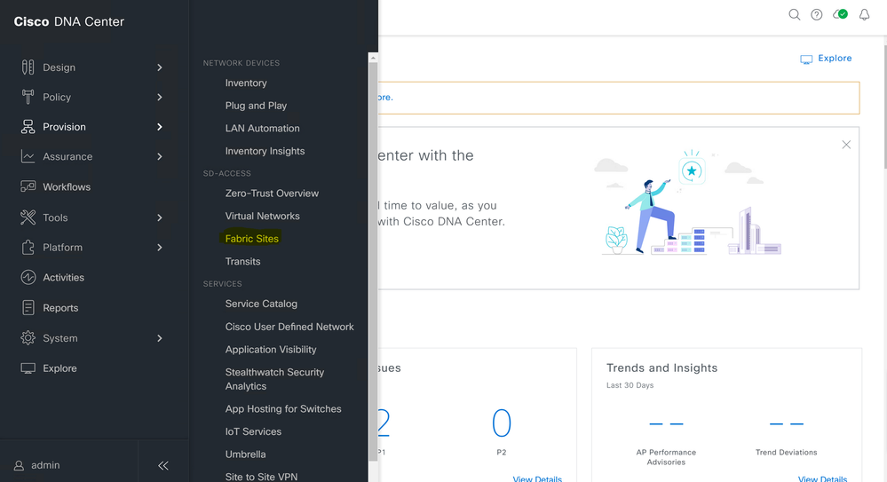

On the Cisco DNA Center dashboard, navigate to the hamburger menu and navigate to Provision > SD-Access > Fabric Sites.

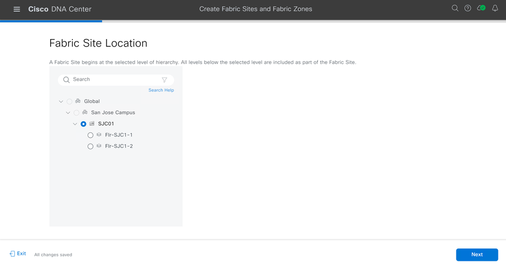

On the Fabric Site Location page, select the building you'd like to designate as a Fabric Site. Click Next

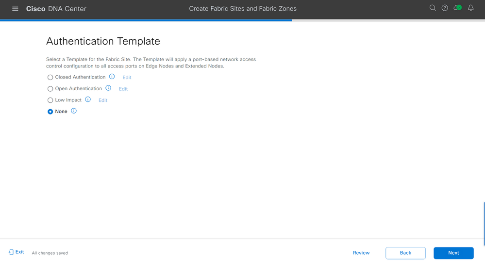

Select the type of authentication you'd like to have for the Fabric Site on the Authentication Template screen. I have selected "None" Click Next

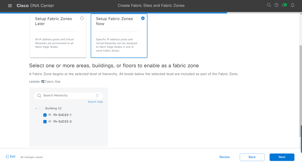

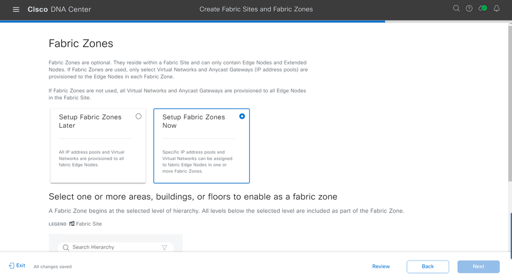

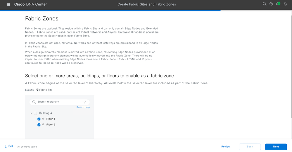

On the Fabric Zones page, select "Setup Fabric Zones Now".
Designate what floors, or building, you would like to be Fabric Zones. Click Next.

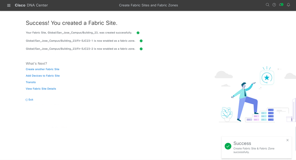

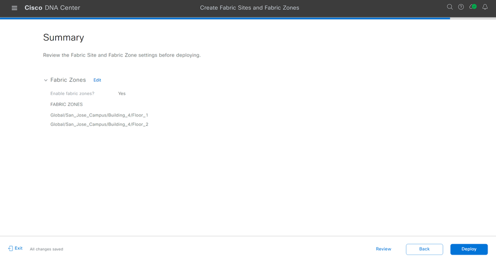

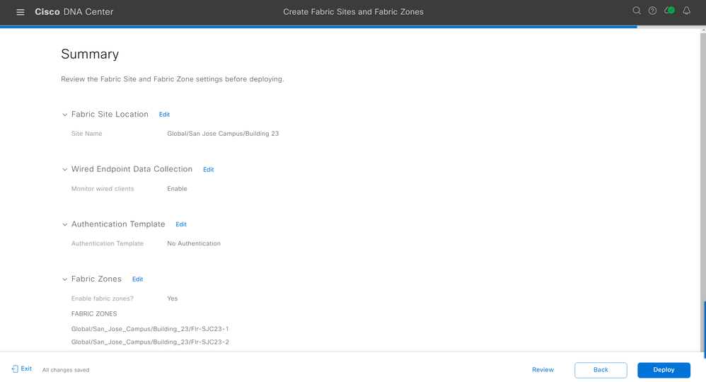

On the "Create Fabric Sites and Fabric Zones" workflow summary page, review your configuration. If you are satisfied with your configuration, click Deploy
Cisco Catalyst Center will deploy and create your Fabric Site along with any Fabric Zones you have also designated. You will be shown if your deployment was successful.

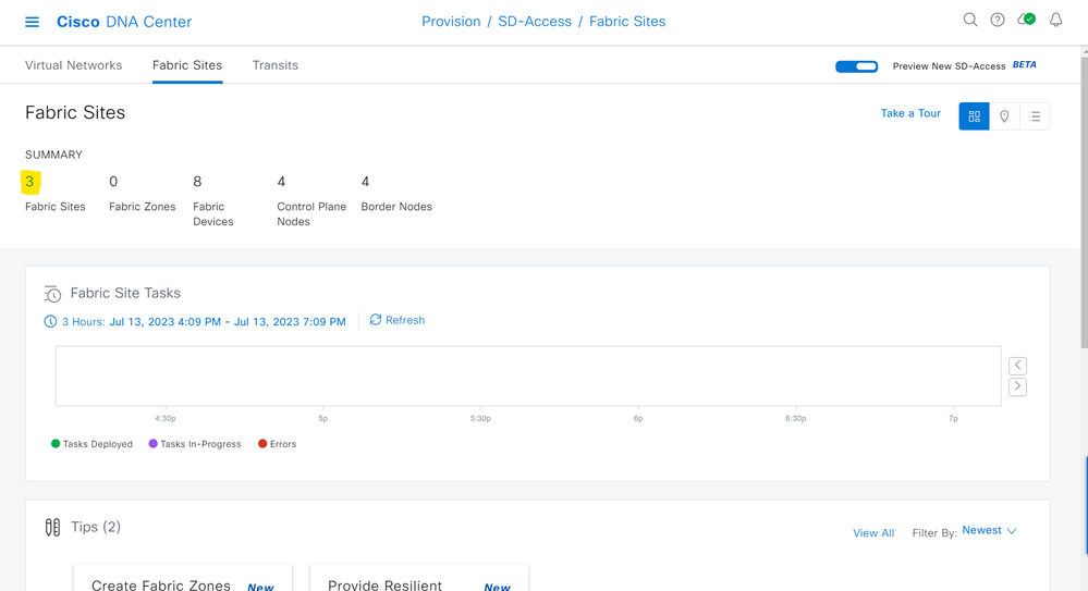

Next, click on the number above Fabric Sites and this will take you to a Fabric Site summary page to view the Fabric Sites you have deployed in your network.
On the Fabric Site summary page, navigate to the Fabric Site you'd like to add Fabric Zones to and hover over the three dots on the right-hand-side. Select "Edit Fabric Zone".

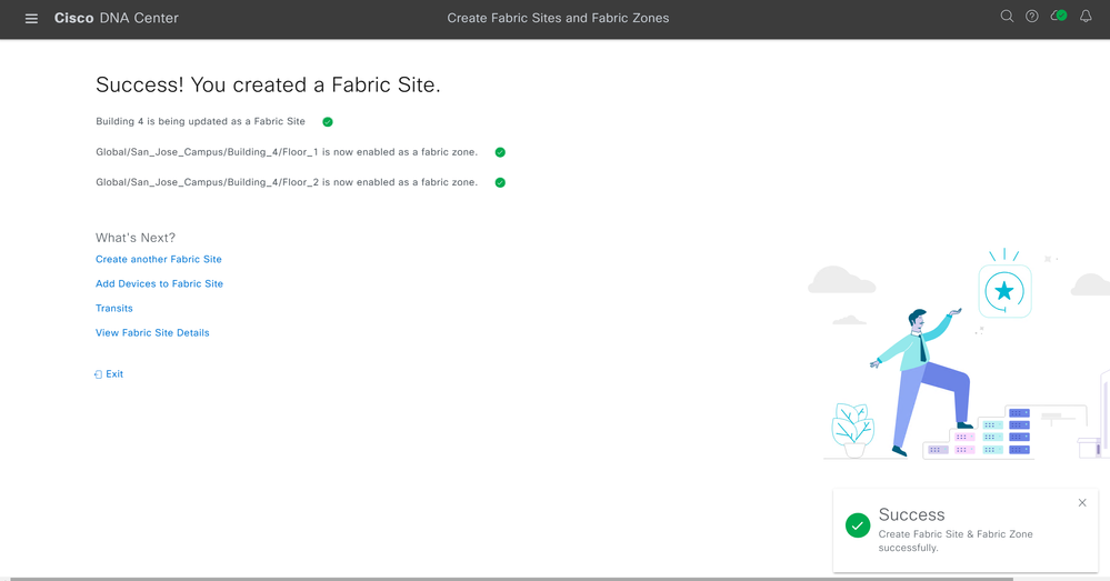

On the "Create Fabric Sites and Fabric Zones" workflow summary page, review your configuration. If you are satisfied with your changes, click Deploy
