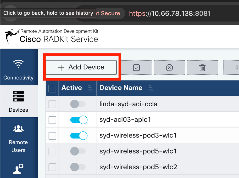

  1. Navigate to the "Devices" section and select the "Add Device" option.
    radkit-add deviceradkit-add device
    2. Input the necessary information, ensuring that "RADKit Service" is chosen from the device type dropdown list. Enter the host management IP as 127.0.0.1, which denotes the localhost. Appropriate Role-Based Access Control (RBAC) labels should be selected. Tick the HTTP option under management protocols, and remember to alter the default port to 8081. Here we recommend use other admin users other than superadmin for security considerations. Conclude by clicking "Add & Close."

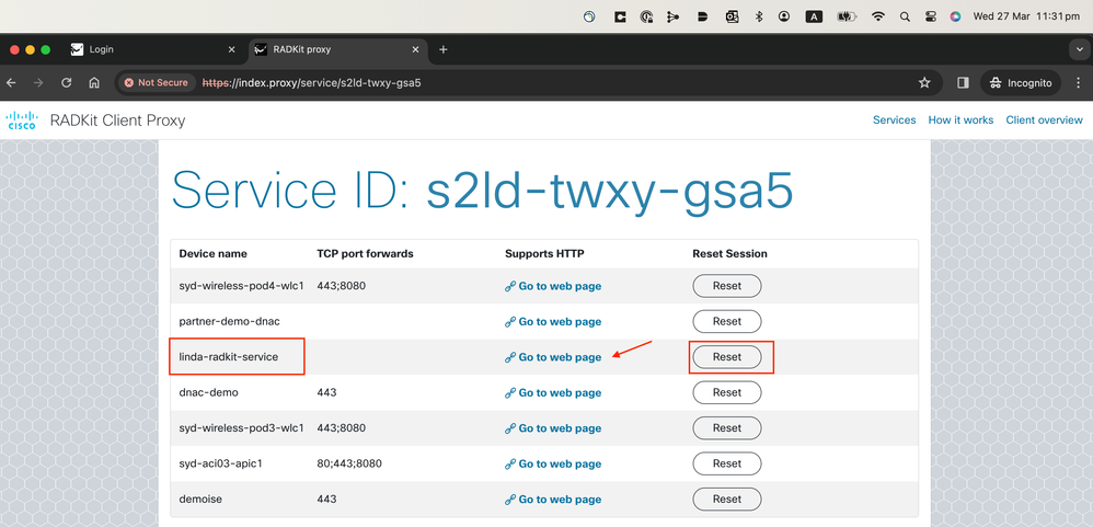

3).  Now let's open  https://index.proxy/ and start to access to my RADKit service without vpn (see in the screenshots, VPN is disconnected. )
No VPN connectedNo VPN connectedhttp index proxy pagehttp index proxy page

Some times, when you click on "Go to web page", it may take you to login page(as shown in screenshot below).
password-less brokenpassword-less broken
Workaround:
Please go back to the index.proxy page, select the service, and click on "Reset" button to reset the session. Then click on "Go to web page" the password-less GUI access should work.
