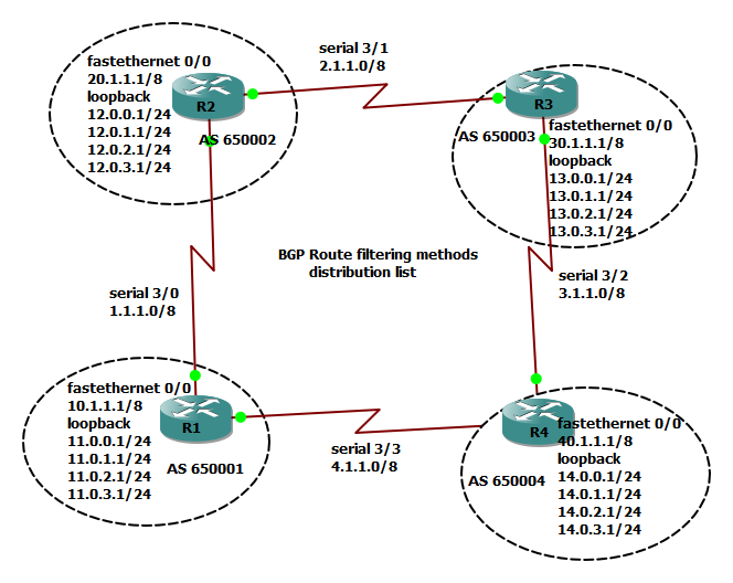

lets see the methods of BGP route filtering:
Topology :https://www.internetworks.in/2019/03/bgp-route-filtering-methods.html
Goal:
  • configure the topology as per the diagram.
  • configure EBGP as per the topology and advertise directly connected interfaces
  • configure router 2 to block 30.1.1.1/8 networks. make sure router 2 do not install 30.1.1.1/8 network in its routing table.
  • configure distribution list in order to block 30.1.1.1/8 network.
R1#show ip interface brief
Interface              IP-Address      OK? Method Status                Protocol
FastEthernet0/0        10.1.1.1        YES manual up                    up
Serial3/0                    1.1.1.1         YES manual up                    up
Serial3/3                    4.1.1.2         YES manual up                    up
Loopback0              11.0.0.1        YES manual up                    up
Loopback1              11.0.1.1        YES manual up                    up
Loopback2              11.0.2.1        YES manual up                    up
Loopback3              11.0.3.1        YES manual up                    up
R2#show ip interface brief
FastEthernet0/0        20.1.1.1        YES manual up                    up
Serial3/0                    1.1.1.2         YES manual up                    up
Serial3/1                    2.1.1.1         YES manual up                    up
Loopback0              12.0.0.1        YES manual up                    up
Loopback1              12.0.1.1        YES manual up                    up
Loopback2              12.0.2.1        YES manual up                    up
Loopback3              12.0.3.1        YES manual up                    up
R3#show ip interface brief
FastEthernet0/0        30.1.1.1        YES manual up                    up
Serial3/1                    2.1.1.2         YES manual up                    up
Serial3/2                    3.1.1.1         YES manual up                    up
Loopback0              13.0.0.1        YES manual up                    up
Loopback1              13.0.1.1        YES manual up                    up
Loopback2              13.0.2.1        YES manual up                    up
Loopback3              13.0.3.1        YES manual up                    up
R4#show ip interface brief
FastEthernet0/0        40.1.1.1        YES manual up                    up
Serial3/2                    3.1.1.2         YES manual up                    up
Serial3/3                    4.1.1.1         YES manual up                    up
Loopback0              14.0.0.1        YES manual up                    up
Loopback1              14.0.1.1        YES manual up                    up
Loopback2              14.0.2.1        YES manual up                    up
Loopback3              14.0.3.1        YES manual up                    up
R1(config)#router bgp 650001
R1(config-router)#neighbor 1.1.1.2 remote-as 650002
R1(config-router)#neighbor 4.1.1.1 remote-as 650004
R1(config-router)#network 10.0.0.0
R1(config-router)#network 1.0.0.0
R1(config-router)#network 4.0.0.0
R1(config-router)#end
R2(config)#router bgp 650002
R2(config-router)#neighbor 1.1.1.1 remote-as 650001
*Mar  1 14:39:06.207: %BGP-5-ADJCHANGE: neighbor 1.1.1.1 Up
R2(config-router)#neighbor 2.1.1.2 remote-as 650003
*Mar  1 14:39:29.195: %BGP-5-ADJCHANGE: neighbor 2.1.1.2 Up
R2(config-router)#network 20.0.0.0
R2(config-router)#network 2.0.0.0
R2(config-router)#network 1.0.0.0
R2(config-router)#end
R3(config)#router bgp 650003
R3(config-router)#neighbor 2.1.1.1 remote-as 650002
R3(config-router)#neighbor 2.1.1. remote-as 650004
*Mar  1 14:34:49.651: %BGP-5-ADJCHANGE: neighbor 2.1.1.1 Up
R3(config-router)#neighbor 3.1.1.2 remote-as 650004
R3(config-router)#network 30.0.0.0
R3(config-router)#network 3.0.0.0
R3(config-router)#network 2.0.0.0
R3(config-router)#end
R4(config)#router bgp 650004
R4(config-router)#neighbor 3.1.1.1 remote-as 650003
*Mar  1 14:36:26.991: %BGP-5-ADJCHANGE: neighbor 3.1.1.1 Up
R4(config-router)#neighbor 4.1.1.2 remote-as 650001
*Mar  1 14:36:37.771: %BGP-5-ADJCHANGE: neighbor 4.1.1.2 Up
R4(config-router)#network 40.0.0.0
R4(config-router)#network 4.0.0.0
R4(config-router)#network 3.0.0.0
R4(config-router)#end

R2#show ip bgp 30.1.1.1
BGP routing table entry for 30.0.0.0/8, version 9
Paths: (2 available, best #1, table default)
  Advertised to update-groups:
  Refresh Epoch 2
  650003
    2.1.1.2 from 2.1.1.2 (13.0.3.1)
      Origin IGP, metric 0, localpref 100, valid, external, best
      rx pathid: 0, tx pathid: 0x0
  Refresh Epoch 2
  650001 650004 650003
    1.1.1.1 from 1.1.1.1 (11.0.3.1)
      Origin IGP, localpref 100, valid, external
(we are going block 30.1.1.1/8 network by using distribution list)
R2(config)#access-list 30 deny 30.1.1.1 0.255.255.255
R2(config)#access-list 30 permit any
R2(config)#exit
R2(config-router)#neighbor 2.1.1.2 distribute-list 30 in
R2(config-router)#neighbor 1.1.1.1 distribute-list 30 in
R2#clear ip bgp * soft
% Network not in table
