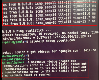

From the router I am able to ping 8.8.8.8 and www.google.com
But user workstation are able to ping 8.8.8.8 but not able to browsers internet like open google.com

""But user workstation are able to ping 8.8.8.8 but not able to browsers internet like open google.com""
this not relate to NAT it DNS issue
you need to push DNS Server to cleint it can your router or external DNS server
MHM

Try
nslookup -debug google.com
Let see if user send to ISP DNS  name resolve request or not
MHM
Hi MHM,
See below output. are not
dmissai
127.0.0.3:53 ?
Are you sure the PC get correct IP and DNS from router ?
