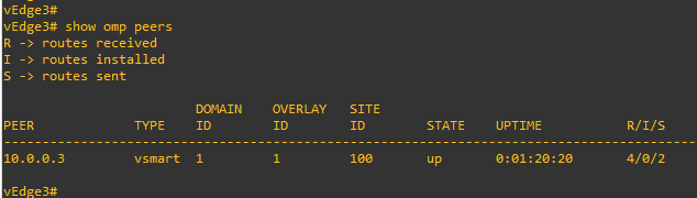

Hi Three vedges are fully connected and can ping each other. Device template are attached to each vedges successfully. But peer can not be seen. Please see the below. Anyone can share some experience or some suggestion? Thank you!
2 Accepted Solutions
svemulap@cisco.com
Edge (v/c) devices form OMP Peer with vSmart(s) ONLY.
They don't form between them.
Based on the output you shared, vEdge3 has OMP Peer State UP with 10.0.0.3
It all looks good.
Hope it clarifies.
It all looks good.
Hope it clarifies.
