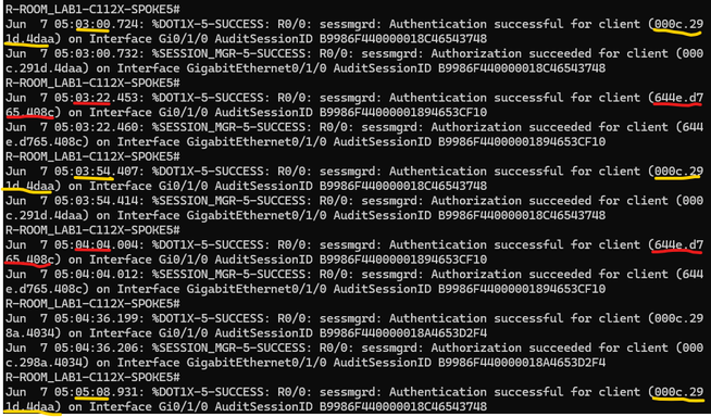

However, for some reason the Cisco device kept reauthenticating the hosts very frequently...
I do not understand this behaviour... I did not even set authentication periodic so this does not make sense to me. And the problem is that every time this happens, the Windows PC prompts me to sign in again in order to give network access to all hosts.

Thanks for your responses. I have tried the setup you suggested, and it works as a workaround in mutli-auth mode. However, is funny because the Cisco device keeps showing the reautentication messages for the VMs, but since I put the credentials on the /etc/netplan/ensxx file for 802.1X PEAP then I don't get any login messages on the Linux hosts and, even though the issue is still there, when I am working with the VMs is "invisible". On the Windows client, even if I save the credentials it keeps prompting the login.
But what really worries me is that if I add more VMs it can get to a point when the Cisco device and the AAA server start getting overloaded.
Now, I have seen that the reauthentication occurs every 65 seconds:
