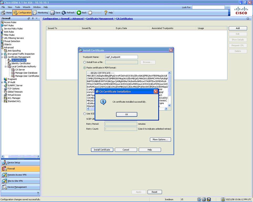

6. (Optional - Only necessary if the phones have a LSC installed and no MIC) If the phones we are using do not have a MIC certificate (and the only certificate that they have is a LSC) then we'll need to add the CA CAPF certificate from the Call Manager. Again, this step is only necessary if the remote phones have a LSC certificate loaded.
To retrieve the CAPF certificate from the Call Manager running version 5.1, do the following (these steps might be different depending on the Call Manager version):
  1. Log into the Call Manager web interface
  2. In the upper right of the screen in the "Navigation" selector, choose "Cisco Unified OS Administration" and click "Go"
  3. Choose the "Security" drop down, then choose "Certificate Management" then "Download Certificate / CTL"
  4. Choose "Download Trust Cert" and then "CAPF". Download this certificate in .pem encoding.
Then, create the trustpoint and import the CAPF CA certificate from the Call Manager onto the firewall

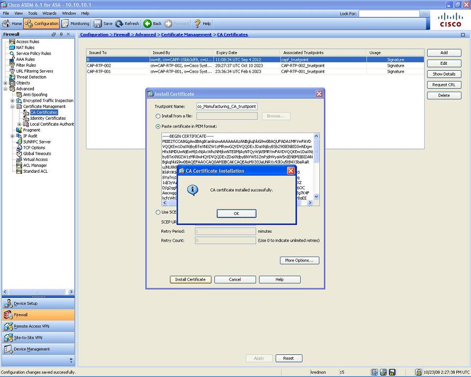

7. It is necessary to load the Cisco Manufacturer CA certificates onto the firewall so that phones that use MIC certificates and the firewall can make a secure connection. Therefore, we'll create a trustpoint for each of the CA certificates CAP-RTP-001, CAP-RTP-002, and Cisco_Manufacturing_CA. These CA certificates can be downloaded from the Call Manager by doing the following (these steps might be different depending on the Call Manager version):
  4. Choose "Download Trust Cert" and then "Call Manager - Trust". Download the certificates (CAP-RTP-001, CAP-RTP-002, and Cisco_Manufacturing_CA) in .pem encoding.
Now, create a trustpoint for each certificate and authenticate them all with the downloaded .pem encoded files:
