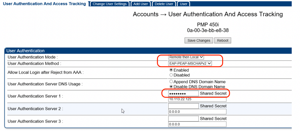

10. Cambium Device Configuration:
Please note that if you are using AD for user authentication, then Cambium device cannot be configured for EAP-MD5 as AD doesn't support that protocol.
In such case, device administration fails with the following error:
22043 Current Identity Store does not support the authentication method; Skipping it
Resolution is to configure Cambium device for EAP-PEAP-MSCHAPv2 rather EAP-MD5
