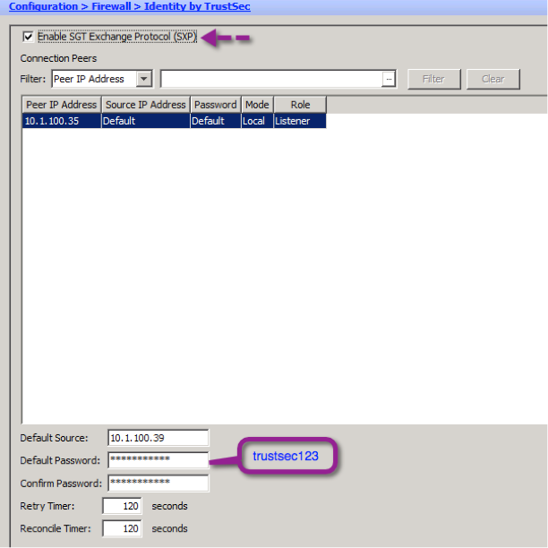

SXP between Nexus 1000v and ASA
In the steps below, you will configure the N1Kv to communicate the Data Center server SGTs to the ASA via SXP.  Remember the goal is to have the ASA act as the enforcement point for user to data center server access, thus it is necessary to communicate the SGTs from the data center to the ASA. Since the N1Kv is communicating the SGTs, the N1Kv is considered the "speaker". The ASA is receiving the SGT information so it is the "listener".
ASA SXP configuration using ASDM
Step 1. Navigate to Configuration->Firewall->Identity by TrustSec and Click the ADD button.AddSXP.png
Step 2. Enter the peer’s IP address and specify the ASA’s roleaddsxppeer.png
Step 3. Click OK
Step 4. On the resulting window, enable SXP and set the password for the SXP connection. This password must match what is configured on the peer devicecfgsxp.png
Step 5. Click Apply
Note: You can verify the SXP connection by navigating to Monitoring→Properties→Identity by TrustSec→SXP Connections.  When the SXP connection between the ASA and the N1Kv is working, the status will show as “ON”.

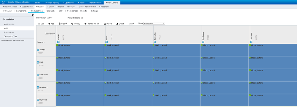

Defining Egress Policy within ISE
Step 1. Navigate to Policy->TrustSec->Egress Policy
Step 2. Click Matrix
Note: The matrix view highlights the cell and the corresponding row (Source SGT) and column (Destination SGT) when a cell is selected. The coordinates (Source SGT and Destination SGT) of the selected cell are displayed below the matrix content area.
Step 3. Select a cell, click ADD to apply a policy
Step 4. Click the orange down arrow and select “NoMalware” for Assigned Security Group ACLs.
Step 5. Click Save
