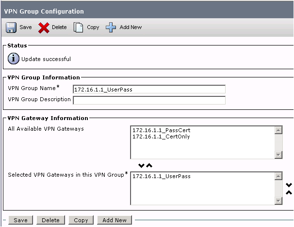

Create a VPN Group using the VPN Gateways:
Add VPN Group and associate the previously created VPN gateway to it:
Go to Advanced Features > VPN > VPN Group
