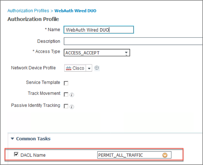

28. Log into ISE, navigate to Policy->Policy Elements->Results->Authorization->Authorization Profiles
29. Create an authorization profile, such as “WebAuth Wired DUO”, with the following configuration:
