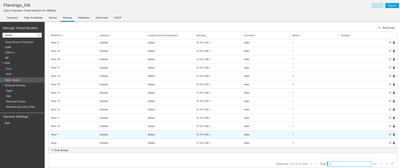

2a) Routes on FMC for FTD (Total static routes available = 41)

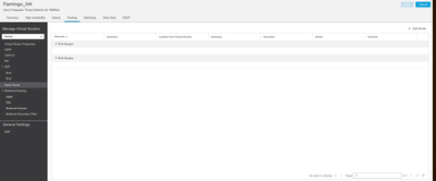

2c) Re-registered the FTD to FMC. Static routes are empty as expected.
