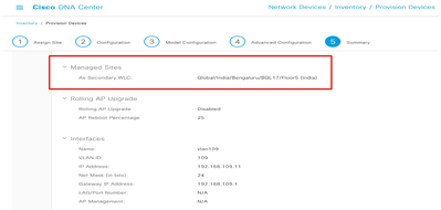

8. Select secondary (to make this secondary WLC) and choose locations for which this WLC will be secondary controller:

2. Provision Secondary WLC. In this scenario its not mandatory to select Primary Managed location for this controller. You can choose to select only the secondary managed location
3. Finally Provision the AP’s. This is where AP gets the Primary, secondary WLC details and Tags are pushed to both the WLC.
