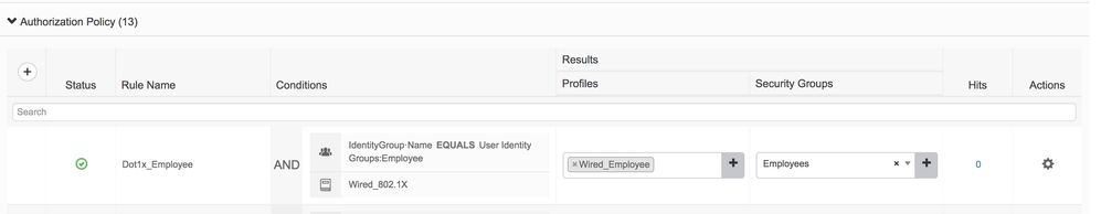

I am setting up a SDA Demo using DNAC 1.3.3.7 and ISE 2.7 patch 1. I will have VN and IP Pool as below
Site IP Pool VN ISE VLAN tag ID/Name
1 172.168.1.0/24 Employee1 172_168_1_0-EMPLOYEE1
2 10.1.1.0/24 Employee2 10_1_1_0-EMPLOYEE2
In ISE, I will setup authorization policy like below:
I want to modify this policy to two policies. One for site 1 and other one for site 2. My question is, I don't know how to modify the condition to match site 1 and site 2?

Hello
You may group devices on each site and apply appropriate policy on specific group
Mike.Cifelli
You have a few options.  You could create two separate global radius policies and then rely on the normalised radius flow type (8021x), and the condition 'DEVICETYPE'.  Utilizing DEVICETYPE you could group NADs to their respective areas, and build out the policies this way.  However, this may interfere with a main benefit of SDA, the mobility aspect.  I think a better option is to breakout your authz policies.  Is it possible to integrate with two separate AD points, and then utilize the ExternalGroups condition?  If not, for demo purposes why not just create two separate local ISE identity groups and reference each one individually and push policy for each respective site.  This would be the quick way to do it IMO.  Lastly, as another option you could focus on device profiling.  In this scenario identify unique attributes ISE has gathered from the NAD sensors, and push policy based on profiled identity groups.  The trick here is determining which attribute/s sets site1 and site2 a part from each other.  HTH!

Hello
Mike.Cifelli
