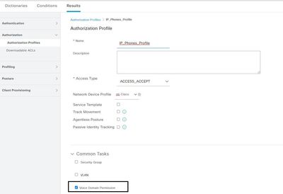

braugarc
As i understand your question , you are wondering why the phones are not been place at the voice vlan during the normal behavior (when ISE is alive , up and running).
 !!!!!!!!!!!  Lets recap the critical vlan concept
Critical VLAN
 was introduced to address the situation when the fabric edges are unable to reach the configured RADIUS servers due to some outage such as a WAN outage.  During this outage, authentications are not possible for newly  connecting endpoints.  This feature creates a “fall back” VLAN so that endpoints can successfully onboard and receive some level of access
SD-Access uses VLAN 2046 and VLAN 2047 for the critical voice VLAN and critical (data) VLAN, respectively.
 ---With that said : you can enable two vlans  one for voice and one for data as a critical for the situation when ISE is not reachable, the new endpoints connections will place at the critical vlans whit out authentication. it is recommended to use a limited access vn for this behavior but is up to you
For the normal behavior when ISE is up and running you don't  need to configure the ports manually , your can use and is recommended to use ISE to send the instruction to the edge devices to which vlan place the endpoints
Fallow the next instructions
For data : you need to fill the same vlan name at DNAC and ISE-Authorization_Profile
For voice : you need to enable voice-domain permission at ISE-Authorization_Profile
See the attached images for reference
Hi
You created a pool for the critical vlan 2046 on the DNAC so you just need to choose voice domain persmission on the authZ policy on ISE and the phones will be on vlan 2046 with the specified IP pool on DNAC as the vlan 2046 is by default on the authentication template on the Switch.
If I understand well what you said, if I want to choose a different dynamic vlan than the 2046 for example the 1022 for phones, I can specify dynamic vlan 1022 + voice domain permission on the authZ policy on ISE and the phones will get the vlan 1022 ?
