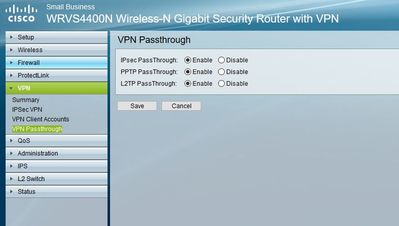

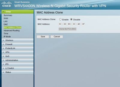

I was able to get the screenshots done earlier than I expected.
I hope these help find out what I messed up.
0001-Router-Setup-Summary-Mod01.JPG0002-Router-Setup-WAN-01.JPG0003-Router-Setup-LAN-01.JPG0004-Router-Setup-DMZ-01.JPG0005-Router-Setup-MAC-Address-Clone-01.JPG0006-Router-Setup-Advanced-Routing-01.JPG0007-Router-Setup-Time-01.JPG0008-Router-Setup-IP-Mode-01.JPG0009-Router-Setup-Firewall-Basic-Settings-01.JPG0010-Router-Setup-Firewall-IP-Based-ACL-Settings-01.JPG0011-Router-Setup-Firewall-Internet-Access-Policy-Settings-01.JPG0012-Router-Setup-Firewall-Single-Port-Forwarding-Settings-01.JPG0013-Router-Setup-Firewall-Port-Range-Forwarding-Settings-01.JPG0014-Router-Setup-Firewall-Port-Range-Triggering-Settings-01.JPG0014-Router-Setup-VPN-Summary-Settings-01-Mod01.jpg0015-Router-Setup-VPN-IPSec-VPN-Settings-01-Mod01.jpg0016-Router-Setup-VPN-Clients-Accounts-Settings-01-Mod01.jpg0017-Router-Setup-VPN-VPN-Passthrough-01.jpg

What is the local LAN IP address of the machine you are connecting from ? Your WRVS4400N has 192.168.1.0/24 configured, make sure the remote PC you are trying to connect from doesn't have an IP address in that same range.
The screenshots showing your setup look fine, I can't see anything wrong.
