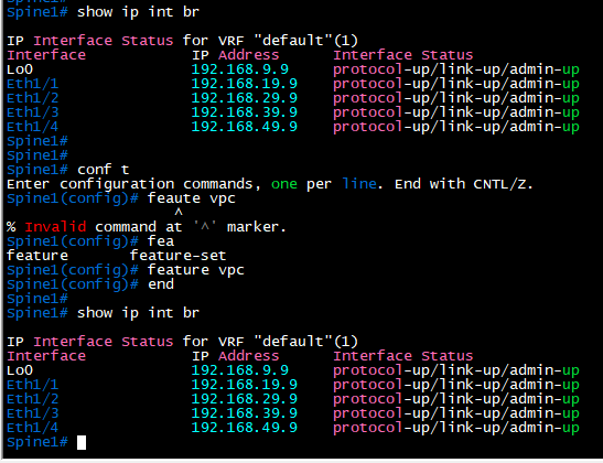

hello!
If i enable the VPC function, the loopback will be down. (nxosv9k-9.3.9 In the eve-ng environment)
It doesn't seem to be down under all conditions, but I'd like to know under what conditions loopback will be down when VPC is enabled.
If i activate VPC in the environment where i am practicing evpn vxlan, it is down, and if not, it is not down, but I will share it.

LO의 mac 주소는 무엇입니까?
config vpc' 이후 시스템의 mac 주소가 변경됩니다.
먼저 기능을 추가한 다음 LO를 NSK에 추가해야 합니다.
제 의견입니다.
