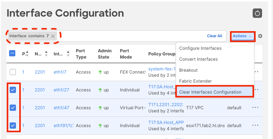

So - to clear an interface using ACI v5.2(7++)
Navigate to Fabric > Access Policies > Interface Configuration
From the Interfaces Configuration work pane, select the interfaces you wish to clear
Tip: You may find it useful to apply a filter first - as in my example above where the filter Interface contains 7 has been applied
Once you have selected the interfaces, click on the Actions menu and choose Clear Interface Configuration.
Repeat for all interfaces you wish to clear
