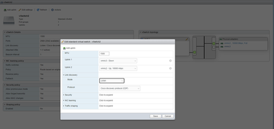

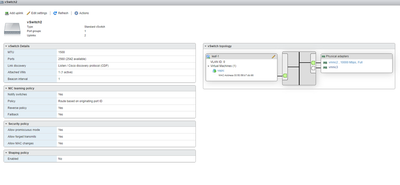

Ok.  We should have started with these details.  Virtual APIC involves a bunch of different considerations than physical APIC (which is what both RedNectar and myself likely assumed you were using.  Some additional questions:
1. Provide a screenshot of the APICs Port Groups connected on vMware (showing VLAN tag etc)
2. Provide a screenshot of the CDP / LLDP settings for the port group APIC is connected to on the vSwitch/vDS.
3. Provde a screenshot of the vAPIC VM settings showing CPU/Memory/Disk configuration
Robert
Hi @Robert Burns ,
I've attached screenshots.
1. I use vSwitch2 with VLAN 0 between vAPIC and leaf.
I have a CDP configuration on vmnic2.
It is hardware configuration of vAPIC
Hi @Robert Burns
I fixed it. I replaced VLAN 0 with VLAN 4095 and everything worked. If I understand correctly, CDP packet forwrding requires a trunk (VLAN 4095), and LLDP packet forwrding requires a bridge (VLAN 0). Am I right?
Yes, the link between APIC & Leaf needs to allow multiple VLANs.  You either do this by creating a trunk port group, allowing VLAN 0 (untagged), the Infra VLAN, the Inband Mgmt VLAN (if used).  Alternatley, if you set the port Group to '4095' that allows all VLANs.  I would harden this to just the VLANs you want to allow (mentioned previously).
The port group dot1q tagging is what I suspected with CDP/LLDP working (rides untagged with VLAN0), but DHCP (which uses the Infra VLAN) was not.   This is mentioned in the Install guide:
