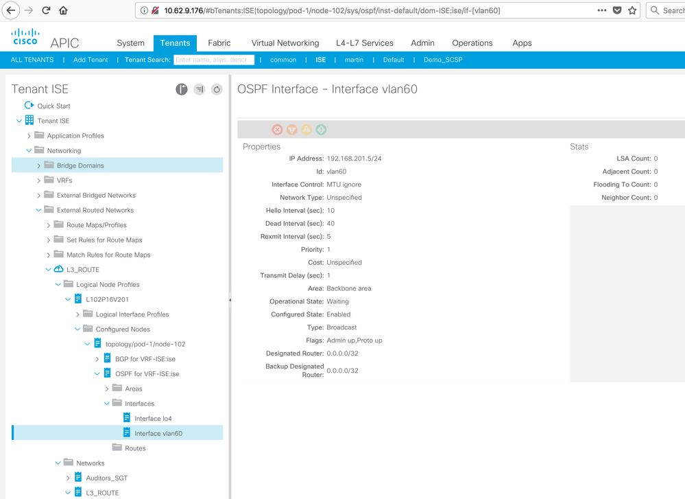

I've ACI leaf connected to external L3 switch via 801.q trunk so, that several VLANs are directly mapped to EPG's via static port binding and then I have one VLAN I want to configure as L3out on ACI. I've created OSFP configuration with an SVI interface mapped to the same physical port and the correct VLAN.
From the external L3 switch, I can ping the SVI interface on ACI side, however, the SVI as OSPF interface is in the Operational State: waiting. I could not find what that means. Here is the screenshot:

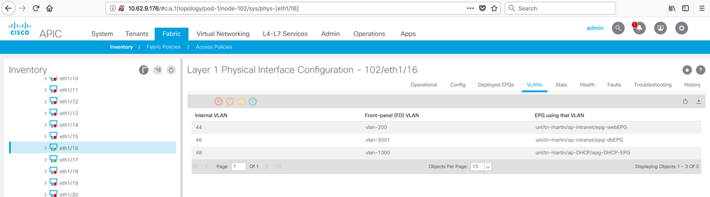

II'm also not sure the OSPF VLAN is deployed correctly on the leaf port, though I can ping it from external device, since on the leaf interface, I can see this:

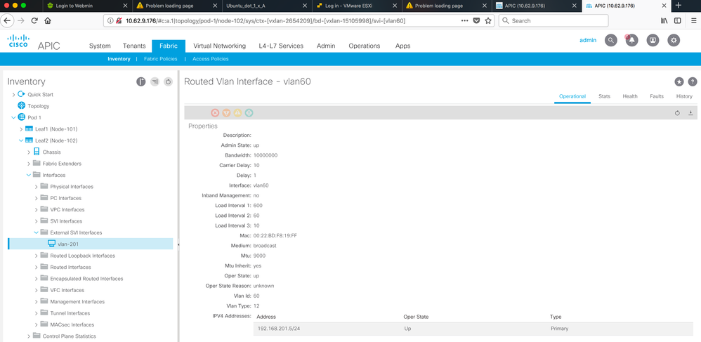

though I can see the SVI interface OK:
Any idea what the "waiting" state means and what might be wrong?
